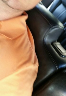

I think the taller middle seat hump functiions as a headrest for shorter folk (at 6'2" and with short legs/large torso, Im a bit too big for it to have much effect)
For anyone under 5'8", a headrest there would be moot.... and, really, how often do you have more than 6 (!) 200+ lb grown men in the truck??? Also, from a legal standpoint that might be moot, since sticklers to the rules will follow the ~1500lb max occupant+cargo weight, which makes 8 XL adults in the vehicle a foul anyway --- although really you can get away with double that
