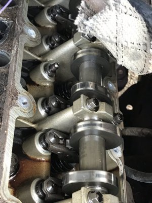

Whipped the rocker cover off to have a look and discovered this. Cam looks to be OK but I’m going to have a proper look another day. What’s the odds of no damage and being able to put it back together and carry on?

Where'd it go?
You're the second one here in a month! Looks like the valve's still there. You shouldn't have a problem. Relatively easy fix, I think. Now check for a broken spring and figure out how to get that all back in there.

As Trainmaster said, check the valve spring to make sure it isn't broken. Check the roller and bearing to make sure it has no lateral movement.
I had one pop out on a 4.6. I went ahead and replaced the rocker and the "lifter" lash adjuster since they were cheap.
I would replace the lash adjuster because even if it feels solid and pumped up with oil now, they can collapse under pressure and speed and let thing slop around and that could cause a rocker to pop out.
I would also fire it up for a few seconds before I put the valve cover back on to make sure it all stays in place.

Just to close this down, it’s finally back together and working (touch wood). The rocker was the only issue I found contributing to the original fault.
