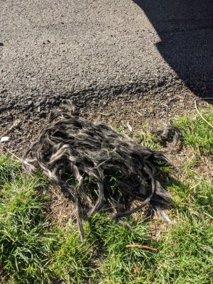

Anyone else have this beautiful sight? 2018 Platinum Max with < 40k mi.
Wondering if an OEM replacement is worth it vs going with aftermarket (likely Magnaflow).PXL_20201116_180911903.MP.jpg

FYI a magnaflow WILL drone like crazy and be really annoying on the highway.
If you want an aftermarket option look at a Corsa or a Borla they are better at handling the drone.
Is yours actually LOUD now that the internal packing blew out? I've seen others saying theirs blew the packing out the tailpipe, assuming yours also instead of splitting a seam or something crazy.

If its not annoying loud, there no need to replace it unless you care that the packing is missing or its obviously loud.

That's crazy! I didn't even know this was a "thing" - detonating mufflers. Is it possible for the packing to break loose and not find it's way out of the tailpipe, thereby restricting exhaust?
Anything is possible. If there's a burr in the pipe, it can catch on it, but will likely get blown out after time.
Yup! Happened on my new Nissan Murano back in 04-05! The packing came out and plugged the whole system. Had to get it towed two hours away to the nearest dealership for them to put a whole new exhaust on, wasn't cheap either, thankfully warranty obviously covered it!
I thought the tranny was shot because rpms would be at 4k and you'd be doing 15-20 km/h!

Can't say how loud it is as it's my wife's vehicle. I haven't driven it yet after this incident. My concern is excessive back pressure due to a clogged system.
With regards to magnaflow, I'm not talking about the cat back system. They are typically too loud for our liking. But a 24" muffler in my experience (albeit a v8) can provide a bit better note without droning. Not convinced yet, just an option.

Finally took this out yesterday evening. Seems to be driving & idling normally, so I do not believe there is any clog (yet??). Sound seemed louder, but I was obviously a bit sensitive to noise, so may just be a placebo effect.
As of now, I don't plan on any changes. Time will tell if the muffler/resonator decides to continue to empty it's contents.
