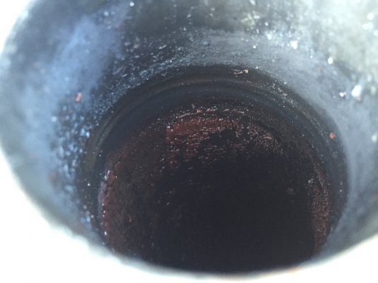

I agree. I am all done. I changed top and bottom radiator hoses. The hoses to the front heater core. The front heater core. Flushed the block. Blew the block out with compressed air. I was able to get 20 plus quarts of antifreeze. I looked closely at the bottom radiator mount and it is solid. The radiator went in easily no binding.
I used Motorcraft Gold. I found what appears to be calcium deposits in the hoses. 6ebd6ababa02d0989ffc7f9d360b0f49.jpg
But the main passages looked clear.
Again thanks for the help. The only thing I did not do is to put the powered cooling system treatment in it.

What does the label say it will do to the system?
I would not do the powdered treatment until I had more information on it.
Looks more like rust and scale deposits in the pic.
