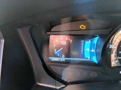

Just heard back from them. They confirmed timing chain has been "significantly stretched". We're going on months of this thing being in the shop with Ford... Now they are telling me they hope to have it done by the END of next week...
