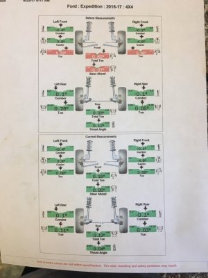

I have this exact lift in front and back. I got a 4 wheel alignment the next day. Instructions were not the best. I believe they came with 3 different instruction sets... mostly for F-150. i did most of it by myself... but getting it back on the front-end was much easier w/2 people. Taking apart is the easiest. Getting everything back on in the front-end was more interesting... the bolts you are loosening/removing on the front do affect camber... i kept them close to what they were and took it over the next day to get aligned. The ride is a bit more stiff and you do hear it clunk on sharp turns as your struts are now extended. your travel is obviously different and you don't get the same extension before you are fully extended. Overall I like the look and ride isn't horrible...but b/w the new tires and lift is much more stiff.
