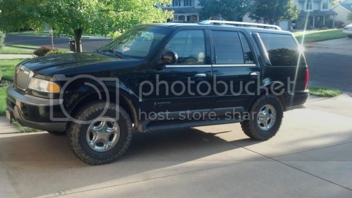

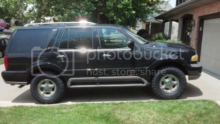

I got my Navigator lifted back in July but never got around to posting pictures. Well here they are: 2 in rear coil spacer, torsion bar crank, 285/75R17 Toyo MT's
[/URL][/IMG]
[/URL][/IMG]

The rear is just a hair low but less than inch. Doesn't help that have a couple hundred extra pounds in the rear with golf clubs, bags set, baseball equipment and the 3rd row seat. If I take all that out it sits just about level.
Ooh, pretty! Is the rear still sitting lower or is that just the driveway angle?

Haha makes sense! Yah I left the 3rd row and audio equipment in when I measured, I still like a lifted navigator!
