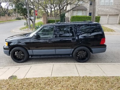

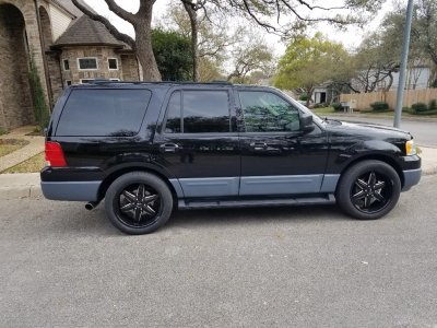

2003 4.6L XLT with 154K miles; same decision and decided to keep and upgrade. Vehicle was already lowered with Eibach kit/Biltstein shocks. OEM radio has been replaced with current tech, navigation, hands free and better sound system. Upgrades were paint and body to remove all dings, scratches, etc., remove all removable parts for paint and paint to original color. Not happy with the bluish gray door side panels that were supposed to be OEM gray so going back to repaint matte black. Steering wheel replaced and both driver and passenger seats recovered. Replaced OEM floor mats with Weathertech mats. 22" Foose wheels with Michelin 275/45 R22 Premier LTX tires.
No issues with motor, good compression, no oil consumption so shorty headers, CAI, underdrive pulleys, electric fans, 4.10 gears and 5 Star tune. Vehicle runs great, surprisingly quick for a heavy vehicle/small motor combination and rides/handles quiet and nimble for a bus. Will look great once the door/bumper trim panels have been repainted matte black. I will post pics when that is done.
Gave up 1mpg, 13 to 12 but worth it, if mileage is important, the Expy is not a vehicle to own. Budget was $10K but final cost was $11.5. Replacing with later used or new were both considered options within my financial means but I love the truck, hated to part with it and saved a ton by keeping and upgrading. When the motor goes, I will rebuild and supercharge.;)
