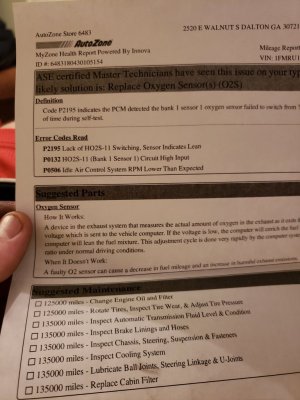

Throws code P0506 idle air control..low idle ,P2195..sensor is lean(lack of ho2s switching) &P0132..bank 1 sensor 1 high input.

Also I'm being told 02 codes could be from the p0506 code and may be a vacuum leak. Or the 02s can cause the p0506 code..I'm confused at this point.
