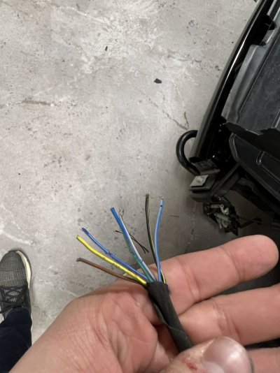

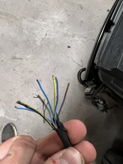

My vehicle was in an accident and the headlight was damaged. Along with the, the connector was ripped off of the harness. I already have the replacement 7 pin but all of the wires are black. Can someone provide a diagram or perhaps a picture of the colors of the wires and which part of the connector they go into so that I can match up each wire on the 7 pin correctly to the ones on the harness? Thanks.

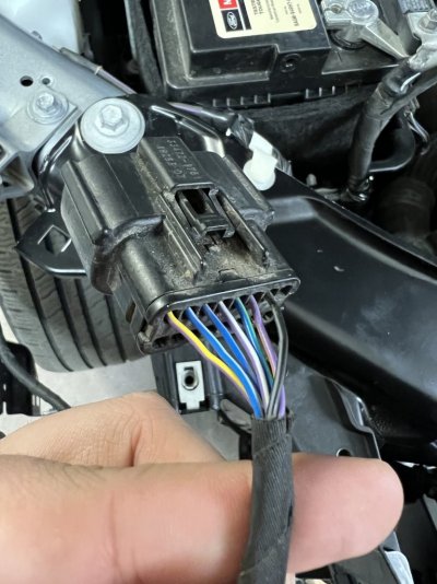

Example of what I need - this is from my passenger side. Unfortunately the colors aren’t the same on the drivers side.
