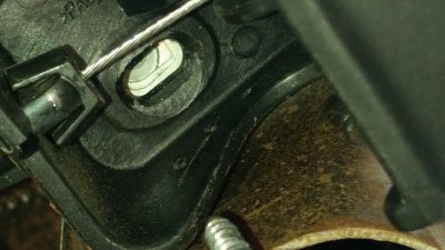

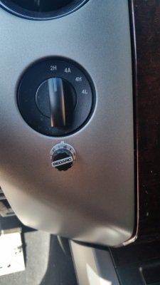

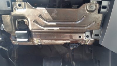

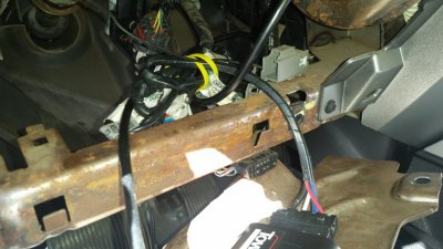

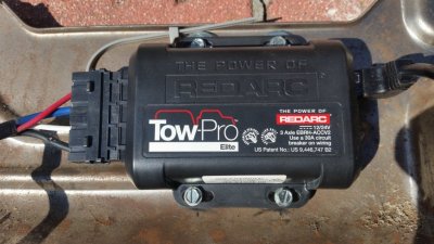

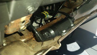

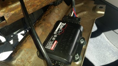

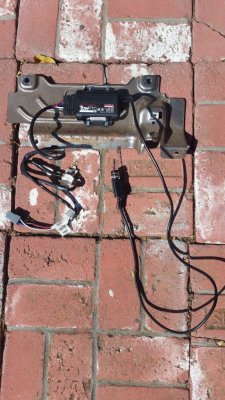

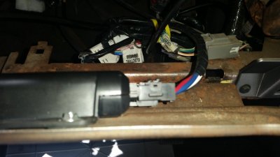

If you're on the taller side like me, you need the leg room under the dash. I got a RedArc TowPro Elite; it has a SUPER clean install. I took pics as I removed mine from my 08 Expy K.R. due to total loss from repair shop damage. Here's some pics of my install; once completed all you see is the little knob under the 4x4 switch.
20190920_110357.jpg 20190920_110350.jpg 20190920_105818.jpg 20190920_105812.jpg
HIDDEN 2nd SCREW UNDER HOOD RELEASE PULL vVv

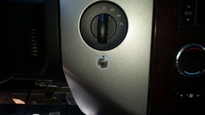

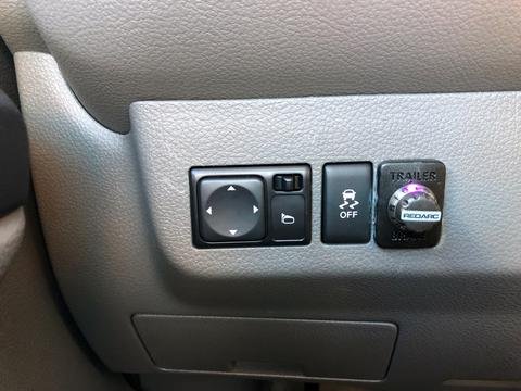

All you see when completed :) :)

How do you figure I "cheaped out" on the switch? I placed it in a place for a quick arm's reach for me as I am right handed. The knob is multi-function and can do everything a knee-knocker brake controller can do. It even learns the trailer brakes automatically during the first dozen or so braking events. It's supposed to be inconspicuous; not a monstrosity.

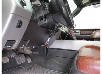

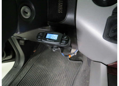

This knee-knocker???
Vs This Clean install?
View attachment 32376 View attachment 32377
If you look back at your previous photo, it doesn't appear there's a cover on it. If the above photo, there is.
It is your vehicle though, isn't it? Good or bad, installed yourself or by an installer, it would your decision which switch is there, no?

Correct, my vehicle, I installed, I use it. The 08 Expy 4x4 doesn't have any blank switch knockouts etc... so I decided to place it near another accessory switch that I use just as much.
I don't see what all the hubbub is about the "switch"... there isn't a selection from the manufacturer. Like I said, it's a minimalist look to the KNOB. Out of the way of leg room.

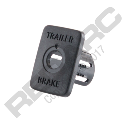

They do offer a selection of inserts for the knob but like I said, no where to counter-sink the insert on an 08 Expy. Would have been nice if Ford offered an acc switch row like in the pickups. But Expeditions were marketed to buyers that wanted the giant 4x4 SUV with the "car feel".
https://www.redarc.com.au/tow-pro-switch-inserts
