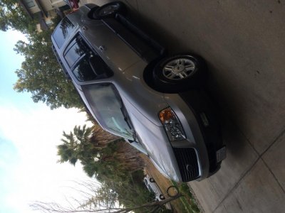

I threw the 0420 and 0430 cat codes today but I did the sea foam throttle body cleaner yesterday, so I cleared codes and and waiting to see if it comes back. I recharged the ac today, we'll see how long it lasts but it's cold for now.
My wife and I really like it. It looks good, drives well, tons of room. I'm just always pessimistic with a new vehicle. I'm pretty **** about maintenance and such.
As I mentioned, my wife's grandpa retired from ford, so this brings us back into the family. I've had 2 mustangs in my youth, a 68 and 87, both 5.0s and I loved them both. I really want this to have a happy ending.

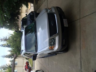

Another photo
Sorry for poor quality photo. It's an xlt with cloth seats. I like them. Wife wants to convert to leather. Drivers seat had a tear but she did a great job sewing it up.
I'm hoping to take it camping and tow a small camping trailer or boat on occasion.
