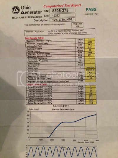

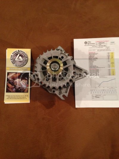

Just received my new high amp alternator from Ohio generator. Very excited about this. Here's a pic of the alternator and spec sheets. Maybe someone can decipher what all that means. Lol

You get you pay for as far as I'm concerned when it comes to this types of things. I wasn't going to trust some eBay garbage. Besides the one your showing me is 200 amps. This alternator tested at over 300 amps. That's where the price difference come in. Not to mention 1 yr warranty against defects.

What kind of questions do you have... I have some questions why you would need 300 amps. I would do it if running 2 batteries and have a lot of accessories running. Just seems a little pricey for excess. And 300 amps is at 6000 rpm! You might wanna save a few bucks for the excess fuel. Jmo so no offense.

Thank u. That's the info I needed. I will call them tomorrow to,find out the pulley ratio. I knew that didn't sound right to me. I actually contacted dc first but they were out of stock and didn't know when they would be available again. I needed mine now. Lol

Found out today the alternator does between 180-200 at idle

Have you looked through your audio manuals or contacted the manufactures on the current draw for your amplifiers and head-unit? Add those up, along with about 60amps for the vehicle applications, to see if 180-200amps at idle is enough without dropping the current?
Someone told me about the 60amps are needed for the vehicle so do not quote me…
Just in case, I make sure no accessories are running; i.e. A/C, heat, and head/running lights. Neutral and a little gas pedal for some higher RPMs will produce some more power. This is why I’m skeptical about upgrading my exhaust system.
