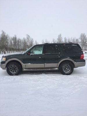

Just bought an 04 Eddie Bauer 5.4L...
Came with:
Recent spark plug change, (had a Ford work order to prove)
K&N filter, (filter ONLY) But this will be swapped for a Volant Cold Air Kit. Mostly because previous owner basterdized the intake box by hacking it up trying to make his own "cold air".....
Black Iron 17" Wheels
285/70/R17 BFG All Terrain KO'2s with about 85% tread
Thanks to this website and the GEN 2 "What to look for when buying a Gen 2".....
Yep..... It has EVERY issue.....
BUT because of knowing what to look for.....
I think I scored pretty well.
Way I see it.....
I bought $2000 worth of tires and wheels......
And got a $1000 dollar truck.
And hey...... our previous daily driver was 25 years older than this.....
Going from a 1979 Suburban (Yes our Daily driver..) to a 2004 Expy.......
I look after em
But I also ride the shit outta em....
Hope it can handle it!!!
It's got some big shoes to fill.
Wife is already in love.... so I call it a win!!
