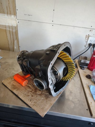

This was the differential in its "pretty much finished" state. I'll post some pics up here soon!

Welcome, very nice mods. What gears did you start with?

Good choice for towing and solo. I have a trutrac to install in mine.

So far, 1000 miles in and running good. I would find a junk yard Ford 9.75 housing and build it, then swap them in. If you are looking for a couple of good housings, let me know, Im looking to get rid of a front and rear.
