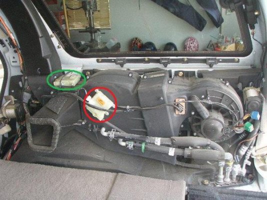

2: I'm hearing a clicking and clunking noise when I first start the vehicle coming from under the panel next to the third row on the passenger side. HVAC actuators maybe? Could this also be why my rear HVAC control isn't working?

Sounds like you got a pretty good vehicle ! Yes, the clicking in the right rear quarter panel is most likely the HVAC actuators. They actually fail pretty regularly. There's videos on Youtube on the repair/replacement job.
The actuator circled in green is the vent outlets door (roof or floor vents...). The one circled in red is the Temperature control door. Many people set them at Cool and Roof vents, and unplug them to stop the clicking noise....

I am going to remove that back panel this weekend to inspect the actuators and order the new ones.
You can get that top actuator without removing the whole panel. There is an accessory tray that pops up and out. You can stick your hand onto the actuator and feel it click to diagnose. Alternatively, if it won't switch from floor to roof vent (and vice versa), the upper actuator is the problem. The lower actuator controls cold/heat.
FWIW, i just unplugged my upper actuator and left it on roof vent.
