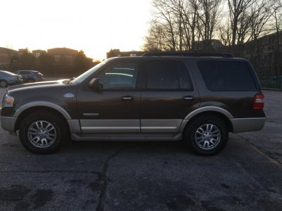

Hey guys, here is a question for you. Does anyone know where I can find the flasher relayon my 2008
Expy King Ranch? I have searched high and low in the truck and scoured the internet for info but not having any luck. I went as far as pulling the instrument cluster and search the whole inside of the dash on drivers side. The clicking comes from a small speaker on the backside of the instrument cluster. The reason I am trying tofind the flasher is that I installed LED lights in tail and front and I am getting hyperflash. I do not want to go with load equalizers because they get hot by creating a short and pulling a load, therefore making me stay away from that situation. I have already purchased a new flasher made to handle LED lights and make flashing normal, but the tough part is locating the damn bastard. Any help would be greatly appreciated.
Thanks
