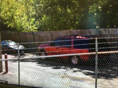

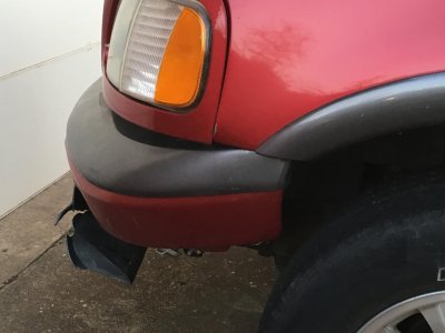

We towed it home, and let it sit for a year and a half in front of my house. Then, a drunk driver was running from the police late one night (in a stolen car no less, no insurance), and ran into it. About a week later, I get a note from the city to get the vehicle off the street (no current tags or inspection). So, I wanted to just dump the thing, but my wife would not let it go. She called a storage place, and had AAA haul it there.
So there it sat, for another two plus years. At this point, my wife had finally had enough of paying $45 dollars a month, and decided to call a junk yard to get rid of it. A few days later, we just happened to go to a hockey game, and met a new couple who were friends of a friend. The guy was a mechanic, and just happened to have the time-cert kit that I needed to fix the cylinder head.

Have new bumper, fog lights, and front air dam valence left to install.
