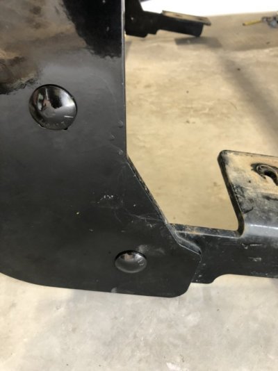

I want to get a brush guard for my 22 Timberline, but couldn't find any that says it'll fit. What did you need to trim for to fit a 2019 onto your 22? I have angle grinders at the ready.

Had to trim where brush guard bolts onto pieces that are bolted under recovery hooks. Here are pics. Sawzall worked better than angle grinder. I took more than I needed to but should have ground down a little more at top and bottom of the cut. Bottom two pics are before I cut, but show the area that needs to be trimmed.690C82F7-187F-4ED8-BBFB-5165D12E9A78.jpegA739830A-A4A9-4AF6-8126-65BEEE3FC791.jpegDAE038A6-804F-49F1-8891-109E15430B77.jpeg22863AF3-2957-4017-A5BF-B3ADC1E979E2.jpeg

Had to trim where brush guard bolts onto pieces that are bolted under recovery hooks. Here are pics. Sawzall worked better than angle grinder. I took more than I needed to but should have ground down a little more at top and bottom of the cut. Bottom two pics are before I cut, but show the area that needs to be trimmed.View attachment 75042View attachment 75043View attachment 75047View attachment 75048
Awesome pics and thanks for the detailed description!
What brand did you go with?
BTW, you sir, are a brave man lol. I might cut and fabricate some shims from my 3/8 steel targets to push it out a inch or so, but cutting that little bit doesn't look bad at all. Hmmmm

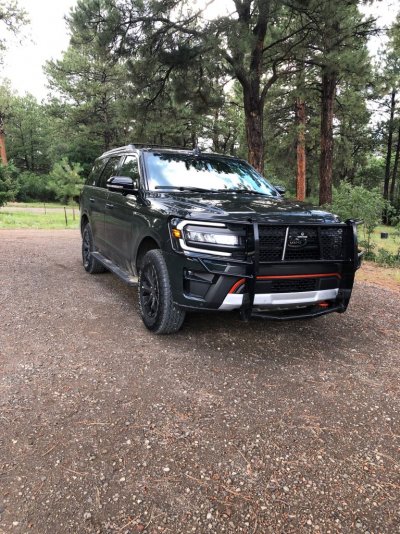

Can you post a pic of that brush guard from a distance? I also have a white timberline and been wondering what it would look like. Thanks
C
Chromo
Mar 1, 2022
20
Colorado
It is a Ranch Hand.
