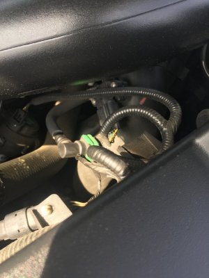

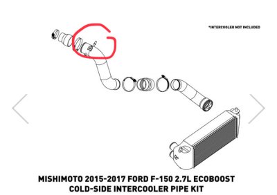

If you look at the cold air charge pipe for instance, 2015-2017 f150s have the pipe that connects to the throttle body with the MAP sensor and quick fitting on opposite sides. This is how the gen2 10 speeds were made.
Looking at the 2011-2014 f150s the MAP sensor and quick connect are on the same side just as our 15-17 Expeditions. The piping, mounting, and hardware are all the same. It’s a direct fit replacement. See below
My 16s Cold side charge pipe
Mishimoto 11-14 cold side pipe
Mishimoto 2016 cold side pipe (notice the different location for the PCV quick fitting)

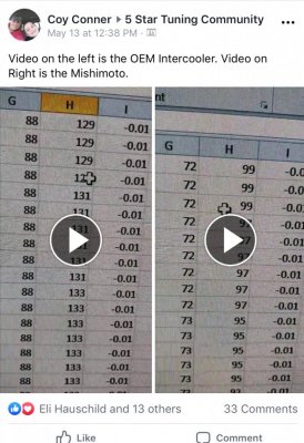

Mishimoto intercooler utilize core 1 from the graph

Here’s is a snapshot of a 2018 F-150 on 93 perf tune from 5star.
OEM intercooler on left. Mishimoto on right
Column H is intake air temp. When he started his first 0-100mph pull it was reading 113 degrees and was up to 138 by 75mph on OEM.
After IC install, his run started at 100 (AFTER 5 previous pulls) and was at 83 degrees at 75mph. Thts 55 degrees cooler folks. Obviously this intercooler and others like it work wonders to keep temps cold and produce more power
