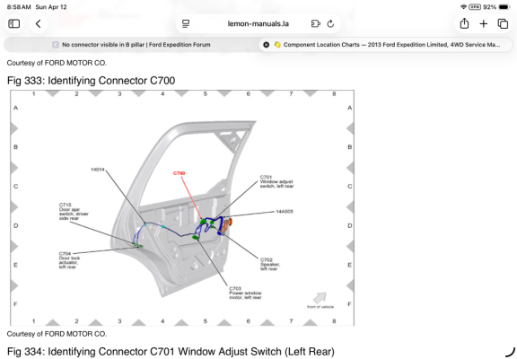

Looking at the power window schematic for your car, there is only one connector between the LR window motor and the main window switch. It is C700 and it is in the door. So you need to remove all the wires in the door and pull them out through the harness hole. It is the same on the Gen 2 cars.
Wrong side but they are the same.
