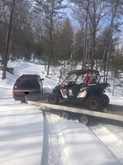

I like my LSD but it can put you in the ditch a lot faster with a road cambered towards the runoff ditch. This picture was last year on my cabin driveway with the joke Hankook factory tires. I also tried it in 4-low and didn’t build momentum. I’d bet my new Michelin Defenders and 4-Hi would make it a lot farther up but I would still have to know when to lift to keep it from fishtailing into the ditch. Oh yeah the Bighorn tires on my buggy had no problems in 2-wheel drive even….lol.70E295AC-F548-4542-8D7B-E8439234211B.jpeg

I like my LSD but it can put you in the ditch a lot faster with a road cambered towards the runoff ditch. This picture was last year on my cabin driveway with the joke Hankook factory tires. I also tried it in 4-low and didn’t build momentum. I’d bet my new Michelin Defenders and 4-Hi would make it a lot farther up but I would still have to know when to lift to keep it from fishtailing into the ditch. Oh yeah the Bighorn tires on my buggy had no problems in 2-wheel drive even….lol.View attachment 71640
Wow. Thats some serious towing !
My use case will be super tame by comparison. Just driving in non-snow conditions to regular commercial RV campgrounds or maybe boat launch.
