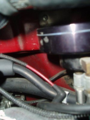

this sure sounds like the IAC on the backside under the firewall or perhaps the dpfe line.
will have to grab a better snap, but for now, see if this helps.
Sorry she's modded.

I see it but i need to know where exactly where it goes... If you could trace both vacuum hoses back from the passenger side of the throttle body, the red and black hoses i would greatly appricate it.
Do you know what that vacuum is for on the side of the throttle body is?

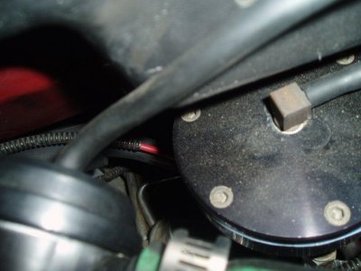

lets try this.
black line goes to dpfe sensor
red line goes to vacuum block underneath my fuel managment diaphragm.
suspect yours is/could be a bit different because of my mods.

Yeah i believe yours is didn't in the black hose because mine does not go to the dpfe sensor. There is only two slots to hook to and they are both being used.
Thanks for the help.
Do you or anyone else know where the black house of the bottom of the throttle body go ona stock 5.4? Lol
