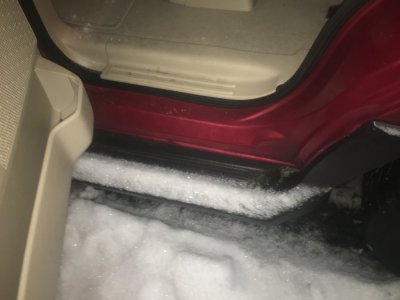

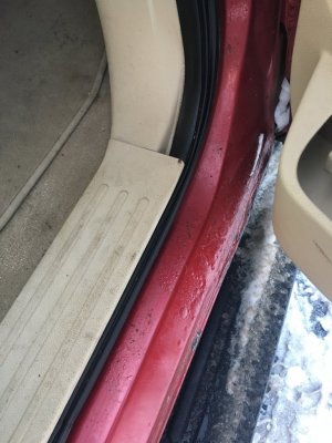

If no one else gets you the pics/info you need tonight, I'll take better pics and get measurements for you tomorrow.
For now though, I already had these pics from a couple of weeks ago; perhaps they will help.
6,530
3,140
Thanks for posting they look exact, same divets and everything... if the measurements are the same I'm going to give them a try. as you can see I have mine coated in Fluid Film which is an oily type substance to try and get them through winter

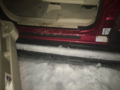

I wasn't sure what specific angles you wanted to see or what specifically you wanted measurements of – so I took these with a tape measure in some of them for scale.
Let me know if you need different views or specific measurements.
6,530
3,140
These pics helped a lot, the only thing that I’m not sure of is the length of the rear door sill other than that they for sure look the same (the rear door opening size looking at the side of the truck). The rest of this pics including the height of the panel appear to be the same on mine. The running boards mount up different, but I don’t know that I’ll even have the body shop put mine back on, probably better to leave them off up here.
