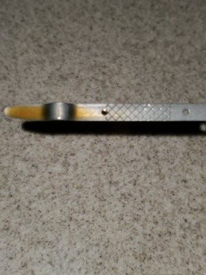

Oh crap very low oil.

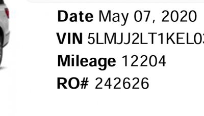

When I had the turbo replace on may 7th the milage was 12,204.
The dealer forgot to fill up the oil,
I brought the truck back and they topped off, and actually over filled abit.

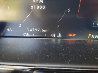

No at 14797 and the oil is barely on the dip stick? That only 2593 miles.
What is going on here?
