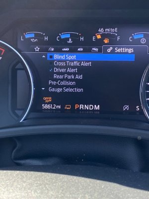

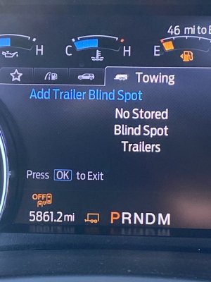

Ok folks .... I've read other posts on this. When I hook up my trailer I get a message that blind spot and cross traffic are disabled (FYI 2020 Expedition XLT with 202a package). Since then, I have tried in settings to enable blind spot (FYI it works fine when no trailer is hooked up). It will NOT let me check the box. Then in towing, I can put my trailer lenght. But I always get the "No stored blind spot trailers". I have tried every which way. Advice?

Do you have a stored trailer? You have to store the length then blis will activate automatically when plugged in.

Yes, I've done that, deleted and did it again. I have two stored trailers (same trailer, different names) and length. I'm getting a new trailer (on order) and will delete everything and start over - if it ever comes, delays in production I've heard.

Well I think I found the problem. I believe that if you set up the trailer BEFORE you connect it for the first time, it does not ask to setup BLIS. Instructions say you can do that, and finish setup later.
I deleted the trailer and then connected as part of setup. I got the request to setup BLIS, which I did, and it worked. Even in advanced settings for the vehicle BLIS is shown as checked.
I'm not sure that was the problem, but it worked this time. I was pretty sure I did it the first time, and it was working, then later it was not working. Really I'm just not positive either way. But deleting the trailer worked. The only problem is that I have to setup Backup Assist again (I find it ok to use occasionally)
