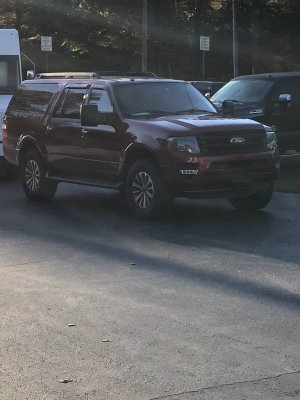

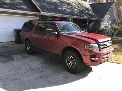

4A949D1B-1F76-4C64-8C0A-A0547786CFF6.jpeg image.jpg Swapped my stock XLT wheels and 285/75R18 Terra Grapplers for a set of 2018 Raptor takeoffs. No rubbing at all, which is astounding as they are much wider and my old tires did rub. ETA: the rubbing was only at full right lock, and the inside of the tire rubbed the fender liner just barely. Turning left it was fine, so I think the liner just sags a little on the driver’s side.
For comparison’s sake:
Stock wheels were 18x8 with a 44mm offset, and tires were 34.84”x11.26”
Raptor wheels are 17x8.5 with a 34mm offset, and tires are 34.4”x12.7”

Looks good, I like what you’ve done to your expy. The darker headlights, black grille, rims come together nicely.

Thanks all. Though the grille isn’t actually black, I just removed all the chrome pieces I had painted gray so I can redo them.
