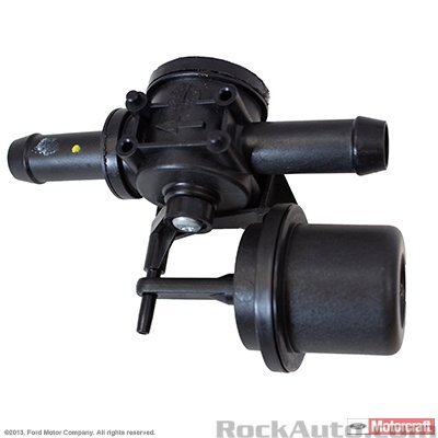

Check to see if coolant is coming from heater valve on passenger side above engine. Will cause lots of problems like you described. If the engine overheats, it will cut back the power to try to keep the engine from seizing. You did the right thing shutting it down.
:welcome: Let us know what you find. Could be a fairly simple fix. These are nice 'trucks'

Took it to the mechanic and turns out the heater control valve snapped, I'm replacing the hoses and clamps too. Looks like its going to cost about $800.

You must have some deep pockets. $80 would have been high for me but I am very picky so I do it myself. More time than money. Look into the condition of the vacuum hoses since they are in the same area :beatdeadhorse5:
