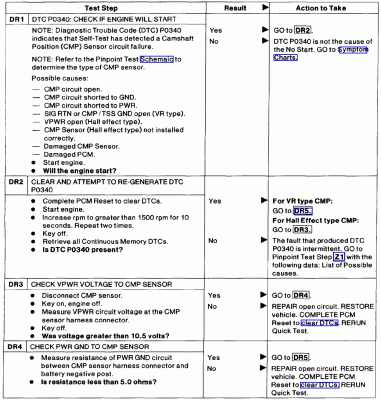

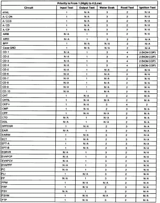

I dont know if any of this will help you but I am going to try and drill down the diagnostic tree based on your responses in this thread. If you need a different branch let me know. I know you already got some of this but I figured Id start at the top.
Preliminary info:
There are two types of camshaft position sensors used, the Variable Reluctance (VR) type, and the Hall Effect type.
The Hall Effect type sensor is used on:
- Mustang 3.8
- Windstar 3.8
- Explorer and Mountaineer 5.0
- E- and F-Series 4.2
- Ranger 4.0
- Explorer 4.0 OHV (VIN X)
All others use the VR type sensor.
This pinpoint test is intended to diagnose the following:
- Camshaft Position (CMP) Sensor
- Harness Circuits: CMP, VPWR, SIG RTN, PWR GND, CMP/TSS GND
- Powertrain control module

Thanks Robbie,
Do you have the step Z1? It's referenced on the second page, but that specific test is not shown on the pages you scanned.
Thanks for checking.

robbieg

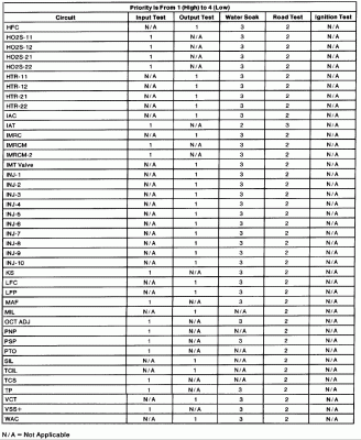

Here is Z1, looks like you might need the Ford tool too go much further.
