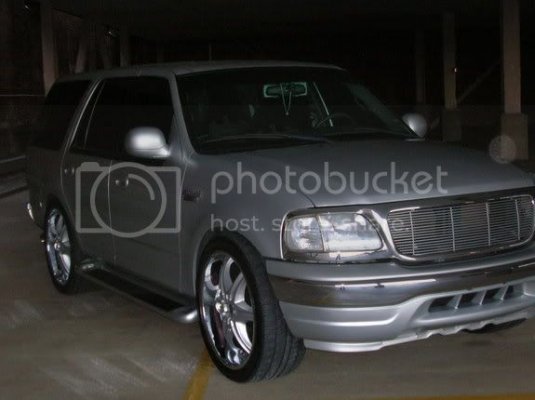

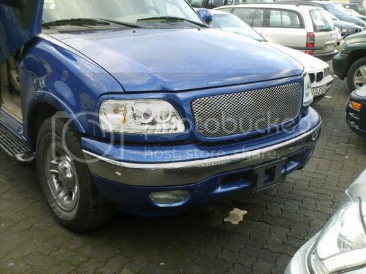

Here's what I'm talking about...they are both definitely stock valances, and they are both definitely painted. Each vehicle does have a custom paintjob, but I'd still like to know what they had to do to paint the valances (and the rear bumper step pad, running boards, mirrors, etc).

Yeah, I know they both have custom paint jobs--I said that--but those are the stock valances for sure. I just wanted to know what they had to do to prep/paint them.
