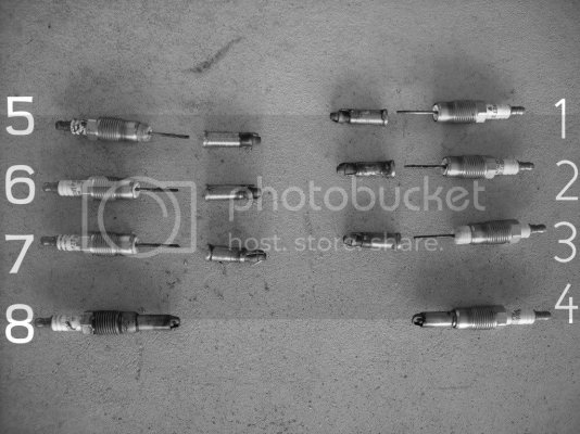

After getting stuck last night since I needed a 15/16 deep socket for the broken plug extractor, I headed out to the auto parts store to get what I needed. Approximately 3 1/2 to 4 hours later, I am done. Nearly every wire/connector needed to be undone on the passneger side of the engine, including removing the PCM and the bracket to reach #4. Once everything was out of the way, it wasn't too bad to reach everything since I had a bunch of extensions.
The crappy part was that 6 of the 8 plugs broke. It didn't matter how often I backed up the ratchet, the porcelain just all of a sudden let go even though I wasn't applying that much force (lower than the 30 lb/ft they recommend). The extractor tool worked flawlessly. I used the Lisle tool I got off of Amazon, and had no problems with it whatsoever. The best part was that the 2 hardest plugs to reach (#4 and #8) were the ones that din't break. Thank God #4 didn't break since there is very little room to work back there. Just glad to get these done and out of the way. BTW, I had 84K on the original plugs (except #8 which I replaced 2 years ago).
