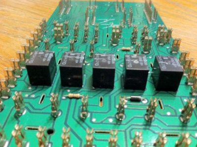

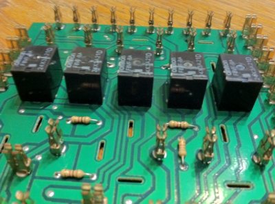

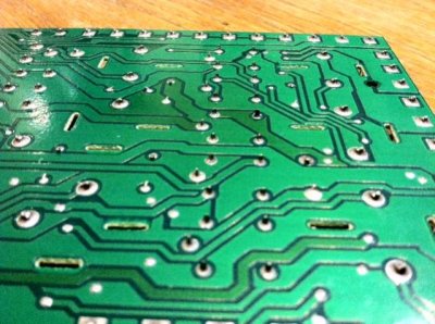

I have the PC board out and there doesn't appear to be any burn marks around R303. But looking on the back side of the board, there does appear to be one very minor cold solder joint for one of the relay pins. Not what I expected to find, so I may check the continuity of all five relays while I have it out and see if there are any shorts. I guess I'm back to searching for other possible problems, including the fuel pump.R303-1.jpg

Thanks bedrck46 for the link - I read through it and it does seem similar. I've also taken a closer look at R303 on by board and indeed a small area of the case is melted and there is slight discoloration on the solder joint for that pin. I'm going to order another relay from DigiKey and replace it. That may take care of the problem but I won't know for a week or so. I'll keep everyone updated.
