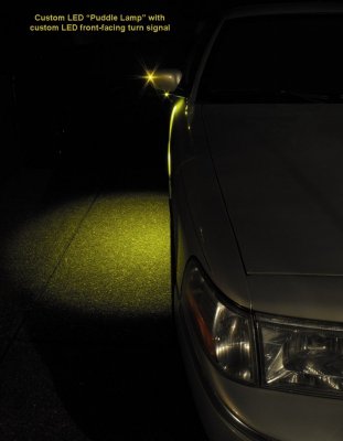

I have purchased a set of motorcycle blinkers to add to the front side of the mirror. The idea is to give more visibility from the front as well as the side. The mirrors have LED blinkers in them, but only face the rear. I will tie the front/side facing blinker in to the OEM blinker, a simple upgrade.
We're getting a bit OT, but I did the same thing on a Mercury Grand Marquis using a simple LED "bolt." It's blindingly bright.

Bolt mount LED? now THAT is a freaking awesome idea.
Any heat issues if run continuously for hours on end mounted thru a hole in plastic?

They don't generate much heat at all! Just be aware the "warm white" units are quite yellow in appearance -- probably around 2300K. I do wish they were a bit more white. I think ideal would be more like 3300K.
