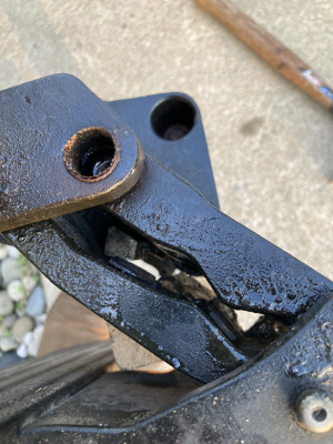

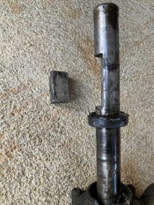

Has anyone had trouble removing the old motor from the bracket to install the new one? I ordered new motors for both power running boards. I removed the 3 bolts, lubricated the hinges, but the slotted steel rod will not come out of the bracket. I have been beating it with a punch but it will not budge. HELP?
Mine were very tight. I used a pulley puller like this https://www.homedepot.com/p/5-1-2-in-Evaporative-Cooler-Pulley-Puller-6100/100122345 along with heavy doses of CorosionX and heat on the aluminum bracket. Good luck and take your time if you can.
