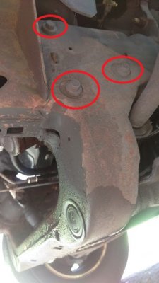

Looking for any tips or tricks on removing the steering gear.
I have a horrible leak coming from the steering gear
attachment.php
Need to replace it as quickly and efficiently as possible. From what I can see, the gear house is mounted here...
attachment.php
Is this about all there is to it? outside of the hoses and steering linkage?

You are reading it correctly, to me the Haynes manuals are useless. You are always better off having the factory service manual for any make when performing repairs.
If you have a steering box (looks like you do) you will probably need a puller to get the pitman arm off the output shaft, a decent torque wrench for the bolts and the torque specs. Replace any cotter pin you remove with a good quality cotter pin, not a .10 cent chinese special.
