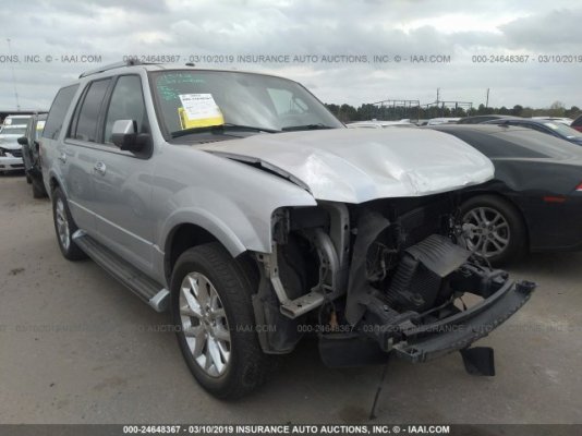

Here are a couple pictures showing the bar. Its connected to the frame horns:

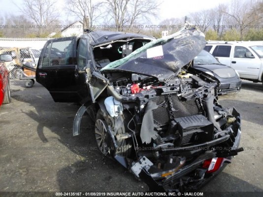

Sometimes they really survive a crash though:

Looks like a bumper support bracket. Probably ok as long as your not noticing alignment issues
