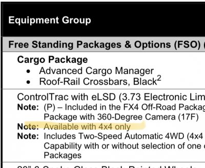

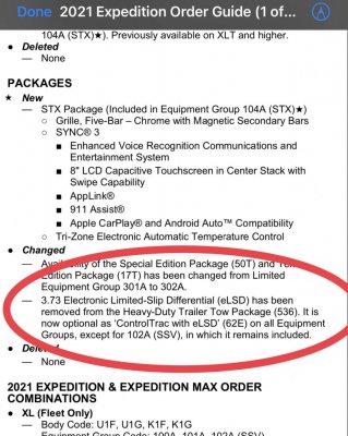

Both of these screenshots are from the 2021 order guide posted in a previous thread. It appears like ESLD is not available for 2wd’s. 68B77F2D-02F0-434F-B8B2-CB8BB739C43A.jpegB59EE7D9-D7BF-47A8-83C3-5DEEC605B6F0.jpeg

Both of these screenshots are from the 2021 order guide posted in a previous thread. It appears like ESLD is not available for 2wd’s. View attachment 38525View attachment 38526
ah and they also only make the special edition available on the 302a for 2021 instead of 301a. Either way me personally I’d be buying a 2020 to take advantage of a deeper discount (or used of course).
Im still intrigued to hear if the eLSD with 2wd is bad news for deeper snow or ice (which would essentially eliminate the 2wd special edition for me as I don’t need to make a 2wd car even worse for that type of weather).
that seems really odd. Looks to say not available, but that line about optional on all equipment groups looks to say it’s more readily available since you could add it to anything without having to buy the tow pack.
