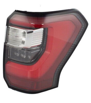

Hi Everyone,
I own a 2019 Ford Expedition XLT equipped with the halogen tail lights, and I'm interested in upgrading to the led light, my question is will it wok fine without adding adapter?
looking forward to see you experience if anyone upgraded.
The one I have like in the first Picture.

That's why the resistors are needed for some models, so the "hyper-flash" & dash warnings do not happen, but OTOH, they won't fix loose or insufficient connections :D
Technically, you need to use FORSCAN to tell the BCM that you have switched from a halogen setup to LED. The is simpler AND safer than using the resistors, especially for the price of FORSCAN vs. the cost of buying resistors. This process applies for adding LED bulbs to the halogen rear assemblies as well as front assembly.

1. To swap out to the OEM LED assemblies is quite expensive. Roughly $1K a pop.
2. An adaptor harness is required to make these work. The halogen harness is different than the LED version.
3. Have not seen any aftermarket options for our trucks and have even inquired with several manufacturers (DEPO, Morimoto, etc.) to which they've replied they have no current interest in our cars. I'm curious as to what you have found.

ok, i just checked the wiring diagram for my 2019... the Expedition in 2019 (and probably 2018-2021(?) has separate wiring diagrams for LED and halogen tail lights. the LED has an additional wire on each side, and the BCM likely requires different program coding.
