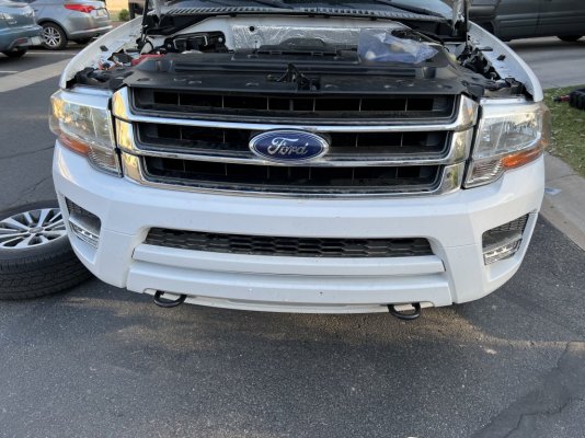

Also, I am trying to get the Grille off, and it seems to be just stuck... not sure what else to do but take the whole bumper off. You have any advice? The pdf doesn't really show that removal process, or I could just be missing it... not sure.

I have to say that after actually getting the bumper off, it actually wasn't that bad... there were too plastic poppets that I missed that held the entire on that took me over thirty minutes to find... but once I did, I had to react fast as it literally come off on top of me. :eek:
