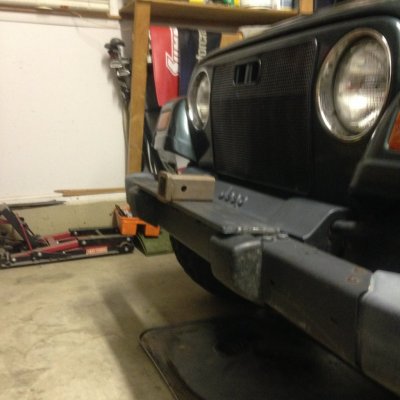

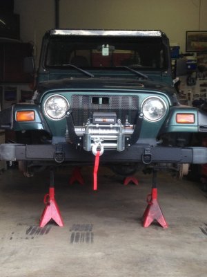

That a great idea! Thanks for sharing. I just welded a steel lintel and a half inch plate steel as more reinforcements on my stock Jeep bumper before I welded on the 2” receiver. But that just my off road woods machine so looks don’t matter and I really didn’t wanna put a big aftermarket winch bumper on my Expedition either. Besides it wouldn’t fit in my garage if I did.68C12080-B8B2-4A94-B65F-F876964A4A64.jpeg E491FEEE-28F9-4ED0-8FEA-04DA4CC16E8B.jpeg

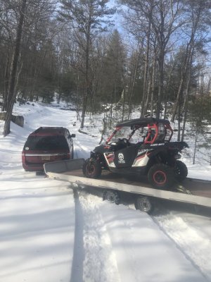

Well after towing 516 miles, and being on the road for 10hrs, I decided to go for broke on the last tenth of a mile. I didn’t make it, but also didn’t break it. The stock Hankook tires with 31,000 miles (now) are a joke compared to the Michelin LTX Defenders that I have on my pickup. I actually towed a 27 ft camper up my cabin driveway in deeper snow than this snow and made it all the way. I have not bought the chains yet, but probably still would have tried without them first. I put it in 4 low which kept me from building momentum. I probably would’ve gotten farther in 4 high but also more f@&$@d as far as trying to back it down around the curve without washing into the drainage ditch on the left side. My F 150 couldn’t make it in 4 low either. I had to get a running start hammer down to barely make it .... but it did. I was able to get it un f$&@$d after I unloaded my new toy and unhooked the trailer and pulled it out of the way with my ATV. I decided to park down the bottom and just shuttle with the new used Can Am Maverick. Now that Beast shot up that hill like a missile! All is good I keep it out of the ditch. The driveway is graded so that the rain water drains to the ditch so it makes it tricky with the truck wanting to wash that way when spinning/buffing.C25176BC-D9A9-4CFC-A58E-17F351BEEDBD.jpegC25176BC-D9A9-4CFC-A58E-17F351BEEDBD.jpeg A0235FC0-B8EA-45E0-9BC9-622FC2FC67B0.jpeg50B9F5F6-9DC8-4283-9CC9-74209FF51CBD.jpeg
