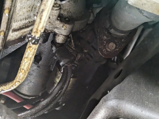

Just got back from a short drive and there is coolant raining down on my driveway from behind the engine. You guys have any ideas before I go taking everything apart? I'm guessing a hose burst. Is there one that is more likely than others? Any suggestions would be great.

Do you smell a coolant smell inside the cabin when you turn the AC blower up ? Like a heater core leak ? With a flashlight, do you see coolant in the engine valley ?

Actually yeah, now that you mention it, there was coolant in the valley and some white streaks around the coils. I thought maybe it was from an old spill, but that doesn't make any sense because I haven't touched the coolant in recent memory

I'm not in front of the car, but I think I know what you mean by "valley" - under the plastic cover in the middle in a small crevasse

Coolant in the valley can come from the o-ring failure at the back of the water pump (search for the water pump mod - very common), or your intake manifold could be leaking, particularly if you’re seeing streaks down into your valley.

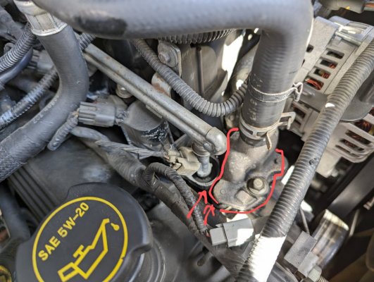

I found a new leak unfortunately. Much smaller. Can anyone tell me what this part? how big is this gasket job?
engineer1
Apr 18, 2020
18
16
Alabama
Be prepared when you remove the intake manifold that you may find more than a gasket issue. My '03 EB had the same leak, but I discovered the gasket is more of a formed O ring seal that sits in a channel molded into the plastic manifold. My manifold had cracked/broken so it no longer contained the seal. I cleaned up the damaged area very well, put some mold release on the old seal and put it back into the channel as a mold. I was then able to reinforce it with some steel (paper clip), and epoxied it with JB Weld. After it cured I installed a new seal, liberally added silicone rubber sealer, and bolted it together before the rubber set up. It seemed to have worked. Much less expensive than a new manifold. Good luck.

You never replaced that crossover gasket ? Could be worse now. Because that joint on the intake manifold to crossover likes to de-laminate along the gasket sealing area if the gasket is not replaced early, and that requires a new intake manifold. Again, buy a pressure test kit and pressure test the system with the engine off. But don't delay that repair.

With the fluid present, I guess it's coolant, it very well may be a gasket, hose or the intake manifold leaking. Though if all I had was the audio I would say it's a vacuum leak.

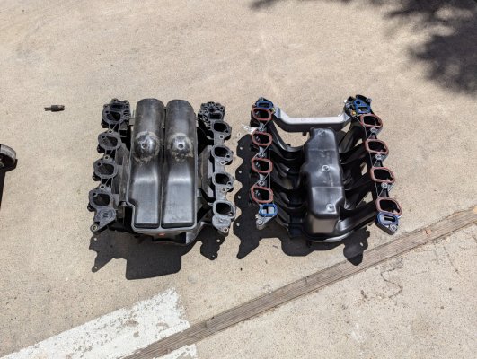

Thanks for the tips. Went ahead and replaced the whole manifold yesterday. So much water in the valley and ignition coils. Gaskets were useless. It smoked a lot when I started because so much fluid drained into the cylinder when I pulled the spark plugs to dry them out. Running well today though. So far no leaks.
Btw, the new manifold is smaller and gives me a lot better access to the valley. I wonder if there's any performance difference.
