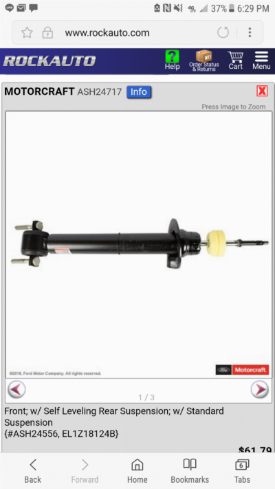

What a failure. I spent all ********* day on this and I failed. I was able to get the shock and coil out, but I couldn't get the shock and coil back on with the spacer on. There's two bolts at the bottom of the motorcraft shock that don't come off and I couldn't get the clearance to get the shock, coil, and spacer on. Then I ****** up a sway bar link and had to race to the auto parts store before they closed.
What's up with those two bolts on the shock? I'm so defeated right now.

Those two bolts replace the lower strut bolt & nut seen in 07-13 iirc
They might not be in your videos or diy guides y
You COULD detach the upper control arm from the knuckle, should give you enough wiggle room
Worst case, drop the LOWER control arm, but have a spare floor jack with a 2x6 to lever it back together after THAT..
PS sway bar links are ALWAYS detached on one side (of each link) whenever doing anything with suspension

I hammered them out which made it a perfect fit back in. Then impact drive them back through the splines and called it a day
I tried hammering them out, but didn't have any luck.

Only other way I to loosen the huge bolt holding the actual lower control arm on and hope it drops down enough for you to be able to apply downward pressure and pop them back in. Extra set of hands pushing down while you set the assembly back in would really help out

Is your Ex even lifted? Anyways @oldpaddy you will need to either punch those bolts out or loosen the LCA bolt to be able to push it down far enough to slide it in if you can’t get the bolts out. Taking UCA off the knuckle will not allow a low enough drop.

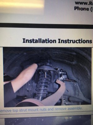

I f***ing know that bro. With everything loose like the instructions from READYLIFT state, there is still not enough room. The UCA is left just hanging there not attached to anything so removing it isnt gonna do shit look here: see how it’s just hanging there?D2B12849-9238-4AB0-8E8A-91E890338B15.jpeg With that hanging there is still NOT ENOUGH ROOM to fit the assembly back in with the spacer due to 2.5-3” of bolts that have to make it back through the LCA. So until you deal with putting one of these in on a truck with different suspension components than yours, do me and @oldpaddy a favor and keep your incorrect instructions to yourself
