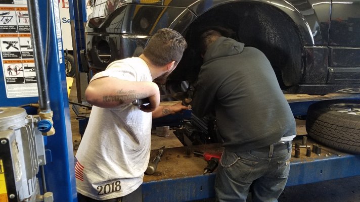

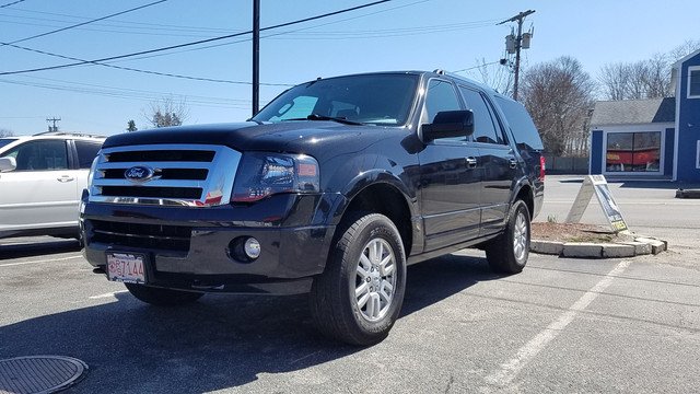

Got her raised!
Felt at home once I got behind the wheel. Much better.
They didn't have to take the bolts off the shocks, but they did have to remove the front calipers and rotors. At one point there was three guys doing one wheel. The front took them a while.
