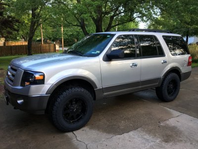

I have the Rancho Quicklift struts on my 2011 Expedition. It has the notorious look of the back squatting. Has anyone had success with adding a leveling puck from another lift to the Rancho struts to get the look a little less squatty?

Its not supposed to do that... rancho owner, NOT speculating
Do you have spacers up front on top of em (youre not supposed to)??
If not, call em up and use that lifetime warranty for a new set of rears
Ranchos, newish, how they're supposed to sit:

Yeah, but if you look at fender gap it does look like the rear end is lower.....

That's cuz it's an integrated levelling kit, it raises the front
That would be a FEATURE, as advertised

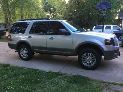

Maybe I’m over analyzing the front lift. Here is a photo of how it sits. (Looking at tire/wheel options today.)

That looks pretty good to me. It doesnt help that you took a crooked picture of the truck on what is probably an uneven surface, a driveway, to demonstrate if it is level...
Either way, it looks good and our trucks have a bit taller fenders in front, they make the front look a tiny bit higher when the vehicle is dead level.
P.S. Your neighbor's excursion looks freaking awesome.

No that front looks lifted or those rears blown (this would be under lifetime warranty so...)
Measure and post heights to ground at top of wheel arches and tire size and we'll even tell you definitively

The rear fender opening sits a lot lower than the front. You can't use them to judge if the truck is level. On level ground, measure up to the rocker panels to see. Yours looks like its sitting fine though.

Measuring from the rockers the back is .5” higher.
Looks like I’m all good.
Thanks for all the feedback.

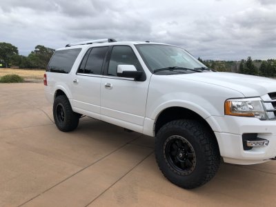

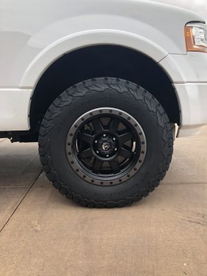

749EE006-29F4-4F0F-AAFC-A68B90980BD2.jpeg EB45C27A-78AF-4D02-B445-AB96CE9910AC.jpeg E9D07A90-FB97-479A-890B-B8A1F46FE3EE.jpeg Here it is ready lift
Fuel Trophy wheels 18 x 9
BFG All Terrain KO2’s 305/65 R18
No rubbing. Drives fantastic. Speedo is like 1mph off.
Now just looking for a good aftermarket nerf bar or running board.
Anyone have any advice?
