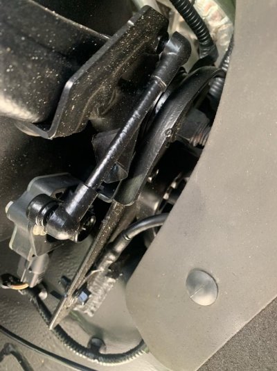

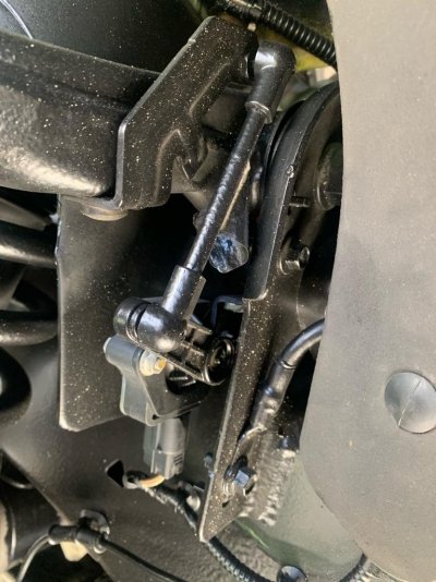

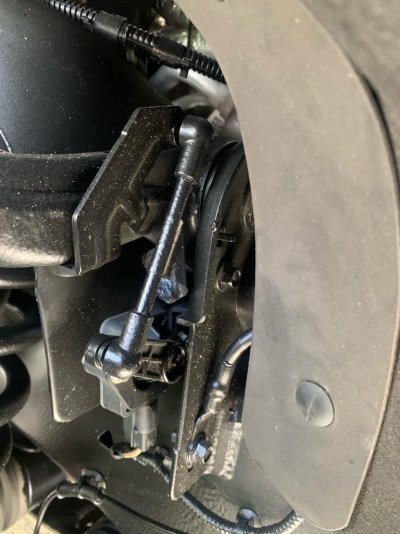

Big H had this kit installed and said Ready lift only need to move the front. He has pictures of the brackets installed.

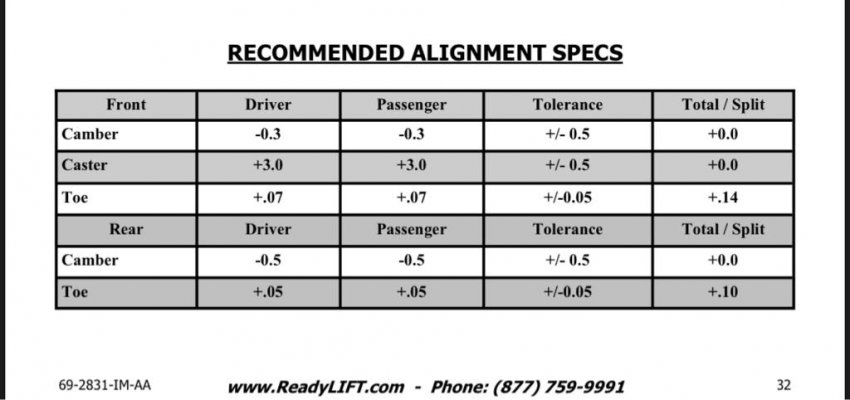

Here are the pics of the front brackets that ready lift now offers for the CCD. I was the first to have this update setup from them. They also have an alignment spec sheet as well for this kit. I’m going agin tomorrow to have them double check the alignment settings.

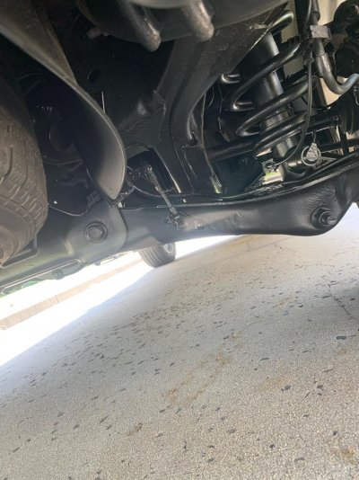

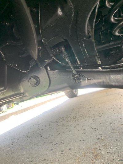

Including last 2 pics of the rear, as they don’t need any brackets or adjustment with this kit. Prolly will get wheel spacers for rear 1”-1.25” to even it out until I get my 33” tires on there.

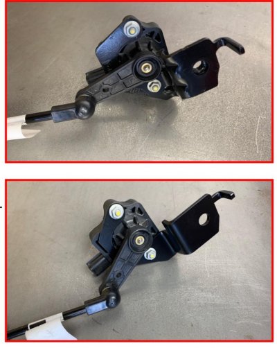

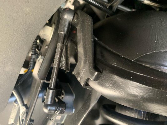

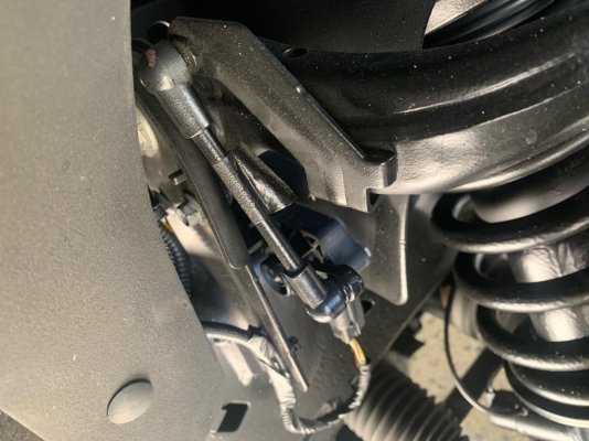

Here is the picture of the difference from the stock bracket to the new one. R/L said they do not need a bracket on the rear. They call the sensor a potentiometer. But that doesn’t really help as the computer can interpret voltage, difference in voltage and rate of voltage change. So if it was a set voltage number per change in dampening it would need all four as mentioned. The other two it would not as long as they fell in the stroke range of the sensor.
Bottom pic is the new bracket installed.
Here it their alignment specs.
