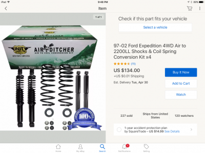

This is what I would try, it's going to save you money
