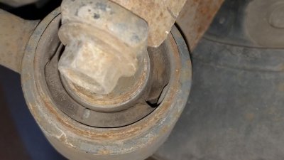

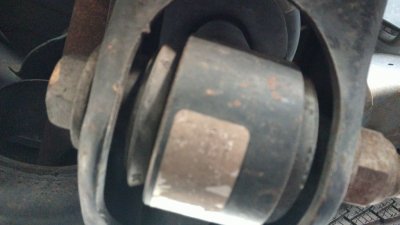

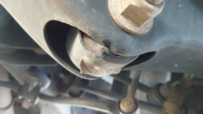

Took a quick look right after supper before the missus I had a meeting and saw a piece of rubber hanging below the strut! The bushing is shot, that's for sure.
Right side, rear
Right rear, but different joint.
Left rear lower strut, for comparison
