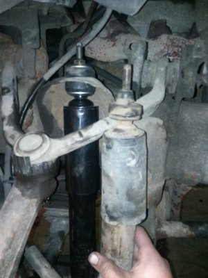

It can however hold the truck down... As I found after swapping my front shocks after I tried to level the front and nearly nothing happened...IMG_20170513_163616.jpg
Not sure why I didn't take a photo of them both out but the olds were clearly shorter than the replacement, and the awful clunk on down travel disappeared.
