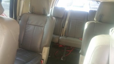

I have done this and it has worked out great. It wasn't hard to remove and now it looks factory since I installed a custom 'T' shaped carpet that was cut for '05 Ford Expy's with the captains chair option. I highly recommend it if the third row is used extensively, like ours with 4 kids.
I have pictures of the interior and also overhead shot of bolt pattern. If interested let me know. I am trying to shrink the pics down to upload but the seem to be too big to post.

Very nice Sam!....I knew someone out there has done this.
Any pics of the T-shape carpet you had cut?
