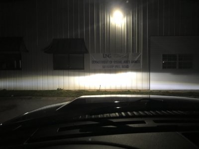

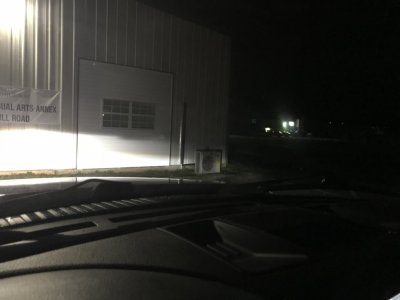

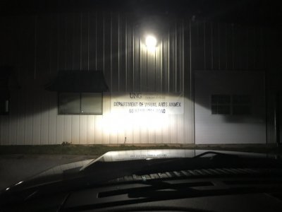

Finally some output pics. Took long enough, but I discovered that my FORScan changes that “seemed” to work actually didn’t, and I was fighting through intermittent issues of them not coming on or flickering nonstop. In the end, I built a relay harness out of stuff I had lying around, and that seems to have rectified the issue permanently.
These shots are at 25 feet with my phone on the steering wheel. Width is pretty good, orientation of the projectors is a little off. There is an ever so slight cant present, which is clearly evident in the right side cutoff and the slight dip in the light output between the hotspots. Since I won’t have time to be without my headlights for the next two months, it’s a situation I’ll probably end up dealing with.

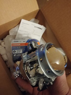

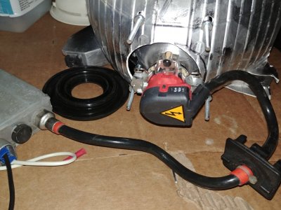

New retrofit for me really soon. Waiting on 1 more item and we start building.
Lexus RX350/ tuned
Osram CBB d2s bulbs
Fresh black housings/ just gotta paint the reflector bucket.
The output completely destroys my Mh1 and can't wait to get them in

Gotta have good lighting man! The RX350 can not be beat once it's tuned correctly. Needs to have a clear lens spaced correctly and secondary shield cut down. I'm also using Hella gen 3 ballasts out of an Audi so they have a max of 6 seconds to warm up.
I'll keep the forum updated as I move along with it.

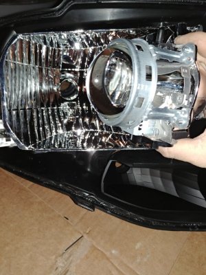

Quick mockup I did tonight. The projector still needs to be pushed back an inch or so, gotta trim the rear of the reflector more to get the projector bowl to sink in, reflector needs to be painted but I think it'll look pretty good
